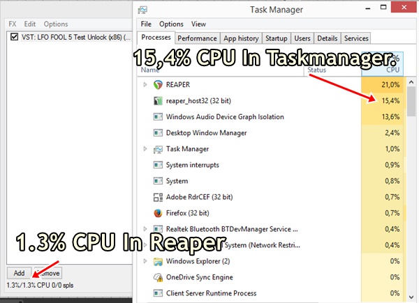

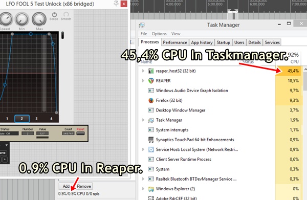

I am making a plugin that has a few moving graphics , a scope , running bar indicator etc.
It takes very little or about 1% cpu in FS but about 14% in Reaper , but only when the GUI is closed.
When GUI is open its about 40% !
I gather that the discrepancy between the CPU reported in Reaper and the actual CPU use is because it runs as another process due to the bridging ?
Is it normal to have a 1% CPU in FS and then up to 40% in Reaper , It seems reasonable that it takes a bigger hit as a VST but it seems excessive.
GUI Open
GUI Closed.
What do I need to take in to consideration for GUI cpu hits and what can I do to minimize that ?

The CPU Meter in flowstone shows only CPU used by the Stream section.
Graphics in flowstone are not hardware accelerated, it all has to be drawn by the CPU.
For that reason I personally think, that you should not put any big continuously updating display (like scopes or an FFT display) in your Flowstone VSTs, it just takes too much CPU.

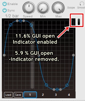

1. One tiny indicator (tiny scope used as an indicator) with 16 samples 100 ticks used as an indicator for the envelope movement.
2&3. An indicator/knob for the CC value ( not needed on the interface, just for testing) and a counter for the cc.
So... I tried a few variations for these indicators to see what was hogging CPU.
1.
Scope removed , midi cc indicator removed - small envelope indicator 11.6% with the gui open
Scope removed , midi cc indicator removed - small envelope indicator removed 5.9% with the gui open
So the CPU is halved by removing that indicator/Scope

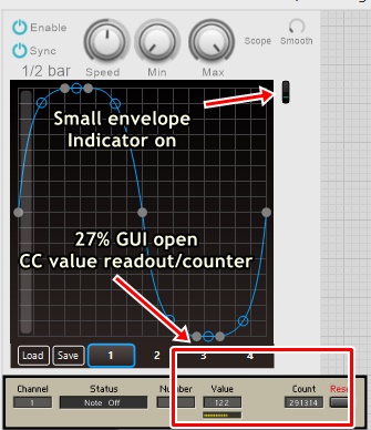

2&3
Scope removed , midi cc indicator intact - small envelope indicator intact 27% with the gui open.
Again , CPU doubled by a small moving indicator.

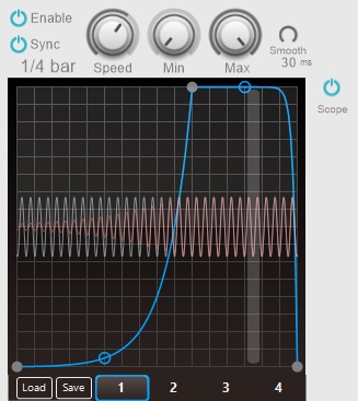

1.Can I decide to take the CPU hit from the scope when it is turned on , but make sure it does not take CPU when turned off on the VST itself?It only needs to be used occasionally and for a short while. It seems weird that when I turn off the scope on the VST it hogs until I close the GUI ?
I only turn off the input to the scope with multiplex, maybe that is the reason...dunno ?
2. Can I make small moving indicators that are fast enough to be meaningful and yet economical ? I dont mind super simple? I feel like I am doing something wrong if I cannot use any moving graphics without such a huge cpu hit.
