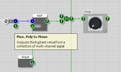

Wait until the new beta version is out, and it will have exactly what you need. It has a new 'max poly to mono' which you can use.
- max.jpg (34.28 KiB) Viewed 29073 times
