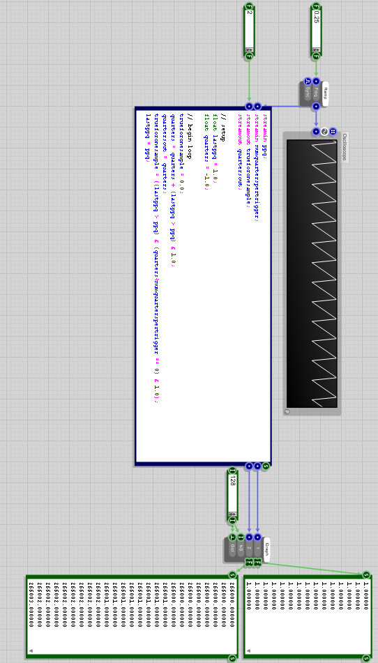

This is what I get on the DSP code...
Only one streamin and no streamout, and the code doesn't recognize anything after the int declaration

Re: PPQ or Something else?
Thanks for the reply!
I tried the code but still don't see the mono readout change (still only zero). I'm just implementing the basis on FL Studio's flowstone plugin for now so not to mess the plugin I'm working on. For now I'd like to see, at least, the mono readout count to the number of bars I would like to wait before trigger.

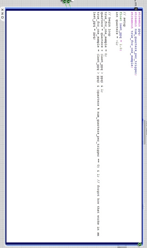

- ppq.jpg (136.53 KiB) Viewed 24872 times
So far I figured that PPQPos doesn't work without an Audio Out prim. (I'm working MIDI only though)
This is what I came up with. So far it seems to do what I need.
Thank you very much MichaelBenjamin for your inputs!!
