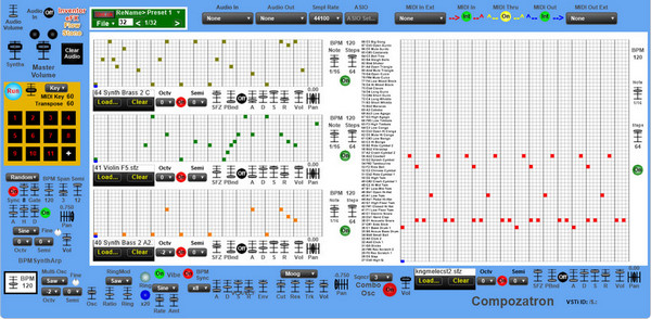

COMPOZATRON HELP
Compozatron
Soundfont SFZ
Musical Graph Grids Sequencer
Compozatron Download Link:
https://www.inventorefx.com/_ifxfstone/compozatron.zip
Soundfont SFZs Download Link:
https://www.inventorefx.com/_ifxfstone/pwesfzs.zip
View Large Image:
https://www.inventorefx.com/_ifxfstone/ ... ron_lg.jpg
INSTALLING THE VSTI PLUGIN
There are 3 different sizes of VSTi Plugins: Large, Medium and Small.
Each size has a complement of 4 x64 (2 ea. 32bit and 64bit) VSTi
and 1 x86 (32bit) VSTi.
One of each different size of ONLY one type is allowable.
CAUTION! DOT NOT INSTALL TWO SIZES OF THE SAME TYPE.
EXAMPLE: LG.*.VST3 & MD.*.VST3 IS NOT ACCEPTABLE!
IT IS ACCEPTABLE TO USE ONE OF EACH SIZE OF ANY OF THE 4 TYPES:
32BIT
compozatron.dll (x86) [v3.0.6x86_32bit Folder]
or compozatron.dll (x64)
compozatron.vst3
AND 64BIT
compozatron (64).dll
compozatron (64).vst3
USING THE STANDALONE EXECUTABLE
After downloading the compozatron.zip file and extracting files from same
open the compozatron.exe folder to utilize the standalone executable ...
Use the Mouse to 'Right Button Click' on the program and select a larger size
for easier viewing and operation of the controls.
For optimum size select 'Full Screen' and then 'Fit Screen' to view properly.
GRAPH GRID ORIENTATION
On the Left of the Musical Sequencer and progressing down:
Graph Grid 1 is for the first Instrument Soundfont SFZ Sampler.
Graph Grid 2 is for the second SFZ Instrument Soundfont SFZ Sampler.
Graph Grid 3 is for the third SFZ Instrument Soundfont SFZ Sampler.
INSTRUMENTS GRAPH GRID MUSICAL NOTE TUNING
The three instrument graph grids are one octave each beginning at Middle C Note
from the bottom of the graph and proceeding upwards in semitone steps.
On the Right of the Musical Sequencer:
Graph Grid 4 is for the Drumkit Soundfont SFZ Sampler (sampler is on bottom of the graph).
The Drumkit Graph Grid has the 'midimap' listing for each percussion instrument on the left side.
NOTE:
Drumkit Percussion Instruments are identified by their respective midimap
(*number) = piano keyboard musical note.
This tuning is based upon the GM (general midimap) reference.
Starting from the bottom and progressing upwards the Drumkit Graph Grid is 'tuned' from
(*27) = Eb0 to (*88) = E5
The description for each individual percussion instrument on the left is based upon this.
DRUMKIT MUSICAL NOTE TUNING
Different drumkit sfzs can vary in tuning for their individual instruments.
This will show non-matching instrument name/tuning on the graph.
Refer to the midimap reference for each different drumkit sfz for assistance.
DRUMKIT SFZ MIDDLE C CAN VARY FROM C3 TO C5 OR EVEN AN ARBITRARY PIANO KEYBOARD NOTE.
USE THE SAMPLER OCT/SEMI (OCTAVE/SEMIITONE) 'DETUNER' TO COMPENSATE.
LOADING SOUNDFONT SFZ FILES
Compozatron utilizes Soundfont SFZ files for the three instrument graph grid samplers (to the left)
and the drum graph grid sampler (to the lower right).
NOTE: It is necessary to 'load' these Soundfont SFZ file at startup.
If Soundfont SFZ files are not already loaded ...
For each sampler chosen, select the 'load' option and open the "pwesfzs" folder included in the soundfonts zip file.
Instrument soundfont sfzs are in the pwemidisfzs subfolder.
Drumkit soundfont sfzs are in the pwedrmsfzs subfolder.
Stereo Drumkit soundfonts sfzs are in the pwedrmstsfzs subfolder.
INCLUDED EXAMPLE SOUNDFONT SFZ FILES TO LOAD ---
Instrument Graph Grid Sequencer Soundfonts:
(1.) 64 Synth Brass 2 C#4.sfz
(2.) 41 Violin F5.sfz
(3.) 40 Synth Bass 2 A2.sfz
Drumkit Graph Grid Sequencer Soundfont:
(4.) kngmelecst2.sfz
The Drumkit SFZ files provide three different types of playback duration.
Filename: *1.sfz --- 'no_loop' version (matches note length).
Filename: *2.sfz --- 'one_shot' version (plays sustained full length for a more natural sound).
Filename: *3.sfz --- 'continuous_loop' version (loops continuously).

Preset 1 sounds cool, but I'm having a problem where, once started, it simply will NOT shut off. In this case, I've loaded the exe, selected my MIDI keyboard, turned MIDI input 'on', turned Key Lock 'off', hit one key: it plays until terminated, no matter what I do. Same for the FSM running withing Flowstone.
A tiny bit of operational instruction would be nice.
