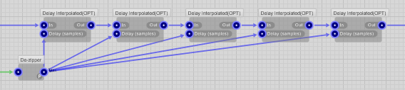

Hmm, is this:

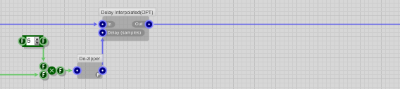

not equivalent to this:
Or am I missing something?

Hi martin,
Thanks for the comment. By 5x I just meant 5 delay lines in series ( 5 times the delay time).
Later then BobF.....
