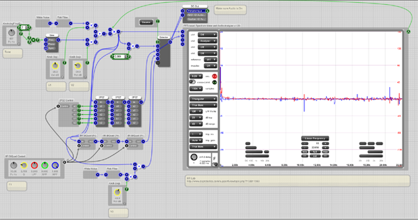

Re: Experimenting with IIR filters
@ MyCo : thanks for this. I agree that comparing the input with the output is a better method. However, a filter being supposed to be a filter, hence modifying the audio that's passing through it, how do you make a difference between "allowed differences" and "distortion or noise"?
In case there is noise or distortion added to the input, you'll see them as random bumps and holes in the Bode plot. In other words, if the filter is producing noise and/or distortion, the Magnitude plot and the Phase plot delivered by the Analyzer will become fuzzy. Let's try this. Here is the setup (see the attached .fsm).
The analyzer is used with ch1 as reference, and ch2 as signal to be analyzed in magnitude and phase.
We don't need the Impulse response.
There is a selector connected to ch2, the channel to be analyzed :
- a copy of the reference signal, with a 1% attenuation for hitting different pixels for the Mag and the Phase
- the signal as filtered by a triple 2P2Z
- the signal as filtered by a triple "handmade BiQuad"
- and a fourth signal I will describe later on
Let's start the Analyzer :
ch 1 : off (no need to display it)
ch 2 : Analyzer
ch3 : Off
ch 4 : Off
reference : ch1
impulse : off
timebase : 0.2 (s)
FFT length : 1024
CPU load should be less than 30%
this means that the audio cycle can go undisturbed
our measurements will be reliable
Triangular windows
True Bars for the gain/phase rendering
LPF Off for the rendering
20 dB top
40 dB range
now the Frequency control surfaces :
show them using the new "F" button
select linear Frequency
full
Let's check the various knobs :
Frequency 500 Hz or so
V1 -20 dB pink noise amplitude
V2 -30 dB sinus amplitude
F1 10 Hz this is the bad guy
V3 -46 dB I'll explain later on
set the audio On
set the timebase to 0.2 (s)
When switching the source (the four inputs), you get the following sequence :
- a perfectly flat and steady red/blue line, those are the Magnitude and Phase nearly overlapping (you analyze the reference)
- a quite disturbed gain and phase plot, time-varying in a random way with bumps and peaks (2P2Z)
- I would say a slightly less disturbed gain and phase plot, time-varying in a random way with bumps and peaks (handmade BiQuad)
- a quite disturbed gain and phase plot, time-varying in a random way, nearly the same as the two above
So what is that fourth signal?
Look the .fsm
Actually we generate as second, non-correlated random signal (seed inside is 5 instead of 2).
We filter it using the pink filter.
We attenuate by V2 (it reads -46 dB).
And we add this ... to the signal used as reference.
Now you understand the meaning of the whole setup.
The aim is to set V3, in such a way that when selecting the 4th source, we get a gain and phase nearly the same taste as when analyzing 2P2Z and/or "handmade BiQuad"

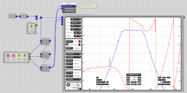

I've got a PM asking to setup a bandpass filter. Here we go. I did a very simple one using three 2nd-order bandpass cells in series. See the attached .fsm.
If you get lost with the Triple Bandpass Control, double click on all knobs. They will reset to neutral and deliver a decent bandpass filter centered on 1 kHz.
Fc is the central frequency
kF is large when the bandwidth needs to be large (coefficient defining the edge frequencies, relative to Fc)
QC defines the Q of the central cell
QE defines the Q of the two cells at the edges
Steph

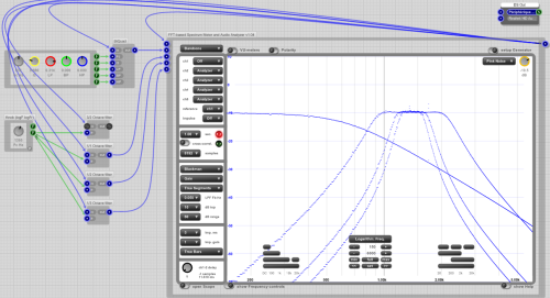

Using three IIR BiQuads in series, one can approach the following classic filters :
- 1/3 octave filter
- 1/2 octave filter
- 1/1 octave filter
- 3/2 octave filter
See attached .fsm

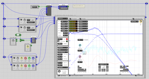

This is an update featuring the new 5-channel analyzer with built-in signal generator, scope, VU-meters and polarity control. A few cosmetic changes to the Highpass, Lowpass and Universal BiQuad filters.
The Universal BiQuad now can materialize 1st-order IIR filters, on top of 2nd-order IIR filters.
For accessing 1st-order IIR filters, you need to set the Q knob to zero.
The 1st-order mode gets confirmed by the disappearance of the BP knob.

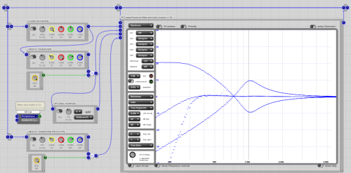

Here is the Linkwitz Transform illustration.
Ch1 is the reference channel.
The closed box resonance model got arbitrary set to 1000 Hz, with a resonance about +10 dB (Q=3). This is ch2. A resonance frequency of 1000 Hz got chosen instead of 100 Hz or 65 Hz for centering the graph around 1 kHz, getting a high resolution graph without needing a 32K FFT size. The .png got taken with a 8192 samples FFT size (and 1 sec timebase for not overloading the PC CPU).
The maximum Linkwitz Transform boost got arbitrary set to +20 dB.
In case the resonance of your actual closed box is 65 Hz instead of 1000 Hz, all you need to do is to multiply the frequencies by a factor equal to 65/1000. In this example, the Linkwitz Transform won't be 314 Hz anymore. It will be 20 Hz.
We start building a Linkwitz Transform prototype producing a maximum +20 dB boost towards the very low frequencies, that we adjust for becoming symmetric with the closed box resonance. This is ch5.
We then build a copy the Linkwitz Transform prototype, put it after the closed box resonance model, and finely tune it for getting a flat frequency response. This is ch3.
As finishing touch, we may add a high slope Highpass filter for protecting the speaker against the very low frequencies, and the huge cone excursion they demand. This is ch4. Such Highpass filter is introducing a strong phase distorsion.
It may be preferable to tweak the Linkwitz Transform for less maximum boost (in fact, +20dB is a lot of boost), by accepting a +6dB/octave slope between 35 Hz and 100 Hz (350 Hz to 1000 Hz in our Fx10 model) instead of a flat frequency response. We'll deal with this in the future.

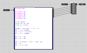

Here is the DSP code for calculating bandpass IIR BiQuad coefficients using the Bilinear Transform. This is a simplification of the Generalized BiQuad IIR filter.
streamin fr;
streamout a0;
streamout a1;
streamout a2;
streamout b1;
streamout b2;
float alpha;
float x0, x1, x2;
float q = 0.900;
alpha = (sin1(fr)) * 0.5 / q;
x0 = 1.0 + alpha;
x1 = -2.0 * cos1(fr);
x2 = 1.0 - alpha;
b1 = x1 / x0;
b2 = x2 / x0;
a0 = (sin1(fr) * 0.5) / (x0 * q);
a1 = 0;
a2 = -1.0 * a0;
