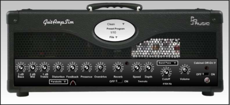

I have been working on and off this project for a while now and am posting my most recent version
1) Revised tone stack to use a 3 band EQ rather than frequency splitter and gain controls.
2) Removed start up tone since it seemed to confuse people.
3) Removed Brightness control.
4) Replace standard distortion with waveshaper.
5) Move filter control to end before reverb module.
6) Added a cabinet sim which can be by-passed. Cab sim based on work by Daniel at his blog.
7) Changed up the graphics and GUI slightly. Knobs are by g200kg, maker of knobman software.
I would appreciate any comments you may have if you get a chance to try it out.
Thanks,
-acg2010 aka Ph D(J) Music

Re: Revised Guitar Amp Sim
Look forward to trying this again mate...bit busy...give me a few days to get to it.....good to see you still tweaking it...

Thanks billv. It was originally created in SynthMaker CM, then saved back in Flowstone. I tried it out in flowstone and everything seem to work properly, however, I could no longer edit the waveshaper.
Let me know what you think.

acg2010 wrote:I could no longer edit the waveshaper.
works fine here...
- stw
- Posts: 111
acg2010 wrote:cabinet sim which can be by-passed
The cabinet sim audio keeps breaking up....not happening here...
but bypassed...it's unreal...really clean and stable audio...
dirty it up and it sounds great man...very very useable...

Thanks billv for giving it a try and commenting back. I have added a frequency splitter before the cab sim to process only the mid range signal. This is how I am building my separate speaker cab sim and it seems to make a difference/improvement.
The revised version is below. I know you are probably very busy but if you get a chance and can try out this revised version and let me know what you think, I would greatly appreciate it.

acg2010 wrote:it seems to make a difference/improvement.
Yeh....
Every preset is good...."muffled" stood out for me this time....
The big surprise was the lack of noise in all the presets.......great job...
