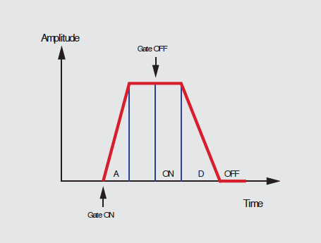

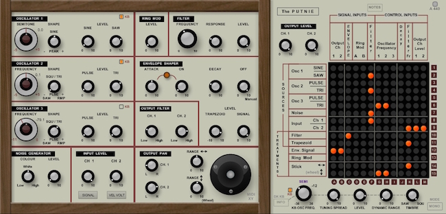

Just finished giving this very old SM build a good FS brush-up. Got the envelope a bit closer to how the hardware worked, but still not quite there. The 'Putney'/Synthi envelope was pretty weird by today's standards.
Here's how it's supposed to work - notice that the 'On' (Hold) segment doesn't begin till the Gate goes off.
So the graphic shows the env staying at full as long a key is held down, then upon release of the key, the Hold stage begins and lasts for the time set by the 'On' (Hold) panel control. Anyone know how to get an env to do this?
I included the oscillator and velocity functions of the DK keyboard (underneath the pin matrix).

The envelope generator you described seems well weird.
I’m not sure what advantage it would offer to a player over a conventional one. Maybe you could explain if/why EMS thought it’s better…?

Spogg wrote:I’m not sure what advantage it would offer to a player over a conventional one. Maybe you could explain if/why EMS thought it’s better…?
Note how k brown's diagram has an OFF period of zero output at the end; a timed "silent" stage - and the control for OFF has a "manual" label at the of its travel. On the original synth, unless OFF is set to 'manual', the envelope restarts at the end of the OFF period, so you end up with a modulator generating a series of trapezoid pulses with control over the mark/space ratio and slopes. When set to 'manual' the continuous looping stops and the envelope has to be restarted with a trigger (the original had a red button next to the joystick for doing this.) So you get the choice of using it as an envelope or an LFO - albeit of a rather unusual kind in both cases.
As for why. I don't know what specific reasoning EMS used; but at the time the VC3 was released, synths were so new that no-one was blinkered by any conventions about how they should be played - as standard, there was no keyboard, even though it's a self-contained set of modules. Bob Moog thought likewise, and was famously totally against the MiniMoog when his development team presented it to him, as he thought that keyboards were an abomination which limited player's imagination for how synths might be played. It didn't help that the VC3's oscillators had such notoriously unstable tuning that playing them from a keyboard was somewhat "Les Dawsonesque". If you listen to Brian Eno's VC3 solos on Roxy Music songs, you'll get the idea!
To emulate it fully in FS, you'd really need two envelopes, so that when the "envelope looping" mode is being used, there's also a "one-shot" envelope to tell FS when a voice can be discarded.
