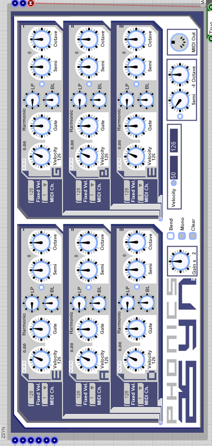

UI->
2SYN hex.png (94.13 KiB) Viewed 43921 times
It needs a hex guitar(a Roland GK3 pickup), which is one with individual pickups for each string.
Also all strings need to be a C string(note 48, .711mm 028 gauge).
The pickup is broken out and run into an interface with 6 inputs.
Then all you have to do is set the on/off gate- using the Gain.
Here is the schematic(open source), VSTfx .dll and the UI resources->
full version 2SYN midi and synth 205->
https://www.sendspace.com/pro/dl/3av2zh
It is 0 crossing based detection,
which relies heavily on a feedback loop to focus the band.

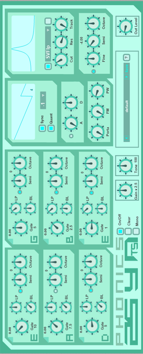

EDIT-> July 2020
I have now made this work for regular electric guitar turning it into synth, which works better than MIDI,
but it does push out the zippered MIDI
here's the project->
https://www.sendspace.com/pro/dl/vnccr5
the .fsm will only open in the FS Alpha sorry, but u could back it up and open it later if u haven't yet joined the Slack group.
Here's a screen->
It works quite well and I would really appreciate it if any of you guitar players would like to try it
-- let me know here how it goes if you'd like to
NOTE: all 2SYN builds require 44.1khz samplerate to process the pitch accurately
Hope it's interesting!-

Postby tulamide » Sun Jan 10, 2016 2:43 pm
Remembers me of the early 90's, when a band member one day used his guitar to play my synth. I thought "Wow, we really live in the future" :lol:
I wanted to have a peek at the schematic, but with 3.0.6 I only get a dozen of "Type not found" error messages and then a crash to the desktop. What is the minimum Flowstone version for it to work?

Postby nix » Mon Jan 11, 2016 11:19 pm
Sorry, it's 309b1
This is very much a current project, and the old .osm doesn't perform well.
I hadn't implemented the cut feedback at that stage.
