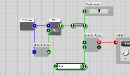

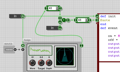

trogluddite wrote:Converting from Green->Ruby
Your "No backward trigger from Ruby" revelation has got me in a mess too Trog :D .
To use my Wave Seq, I need Ruby to automaticly read the @note.
Having to push it in has put me back into the green, I knew that would be trouble.
Code: Select all
def init
@note
def event i,v,t
    on = Midi.new 144,1,@note,12
    off = Midi.new 128,1,@note,12
    output 0,on
    output 0,off,t +0.25
    output 1,on
    output 1,off,t +0.25

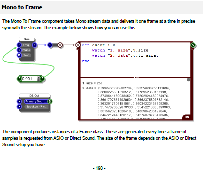

Note:
What's the deal with this Mono to Frame thing?
This "precise sync" statement is a bit of a turn-on.
Can it be used for a PPQ set up. ???
For me also looks like a alternate way to spit out data from my Seq or Mods, and bypass a lot of green.

Postby trogluddite » Sat Mar 02, 2013 2:35 pm
Hi Billy,
The notes trigger situation may be a matter of taking control of the trigger flow - this works a little differently in Ruby compared to what we're used to, but is actually very flexible once you get used to it.
Let me know if this is correct...
I am guessing that you have an incoming note value coming from part of your schematic - but you don't want the note to actually play until it receives a trigger from some other part of the schematic that handles the timing?
With the Ruby in your post, what is happening is that the note gets sent when the @note value changes, which fires the MIDI at the wrong time, and possibly with the wrong value - but if you block the trigger, it won't get sent at all!!
By adding a little code to the "event" section, it is possible to separate "update note value" and "send the note" into two completely separate events.
Here's a little example of how you would do that - hopefully the comments in the code will make it clear what is happening....
Trigger Testing.fsm
(1.79 KiB) Downloaded 2086 times
PPQ
Yes, I think you're on the right track. A frame is a collection of samples that is exactly one ASIO buffer in size, and totally in sync with the VST host. It's weird at first because we are so used to the SM "one sample at a time" way of doing things - but in reality, the host always sends data in buffer-size "chunks". SM has been hiding this from us for a long time!
Now, finding the beat starts should be quite simple - grab a 'frame' of the PPQ signal, and scan the data until you find that point where the ramp resets. ASIO buffers are so small, I think we can safely assume that there would never be more than one per frame!!
You could possibly also look for crossing other values in the ramp (e.g. 0.5 = half beat) for smaller timing divisions.
If the frame arrives at time "t", you should be able to say that the MIDI event needs sending at some time "t + offset", where offset represents how far into the buffer the crossing happened.

Last night i spent a few hours with the Mono to frame. Got some interesting results from it.
Seems it can be used as a "Ticker" extracting a green tick from blue.
( The Code in the Mono to frame module is the same from the User Guide.)

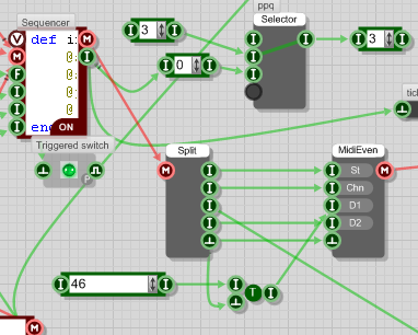

trogluddite wrote:Here's a little example of how you would do that -Trigger Testing.fsm
Thanks mate. I see what you mean.
I didn't mention it, but i already had a S&H on the @note, with the tick pushing it in.
I started to test your method last night, but went off on several different tangents instead.
I'm still playing with the "silly" idea of bringing the Ruby accuracy down to green :lol:
Did about 6 versions.... this one is interesting, it's 100%, note is green. All I got to do,
like you said, is change it at the right time.
billv
