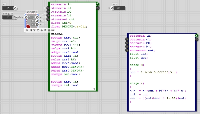

Do I need to worry about this inside the K-S IV?
1pole HiCut.jpg (129.19 KiB) Viewed 18797 times
Was this module superseded?

I fixed this by toggling the Ruby inside the 'error alert' module off, then on.

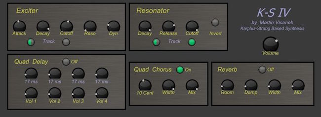

Two By Three's GUI is based on a commercial plug-in (Ableton Operator), so best to stay away from that. Since you seemed pleased with the GUI for RandomOsc 4, here's K-S IV (with Spogg's additions and presets) in that style.
K-S IV_s copy.jpg (26.68 KiB) Viewed 18509 times
K-S IV_s.fsm
(220.78 KiB) Downloaded 1002 times
And a 'lite' version with just the Karplus, stripped of the effects.
K-S IV.fsm
(155.35 KiB) Downloaded 995 times
With FS 3.0.8.1
