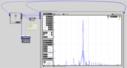

Me to, I can testimony that the bidirectional IIR filter works! When the buffersize is bigger than 256 samples, the 1 kHz distortion spectrum falls under the -120 dB line. See attached screenshot. The weak distorsion peaks that you see, are already in the test signal, coming from Flowstone built-in Sine component.

I did a 2-way Linkwitz-Riley 4th-order crossover. One Butterworth 2nd-order in the forward direction, plus the same Butterworth 2nd-order in the reverse direction. It makes a 4th-order filter in total.
The knob defines the crossover frequency.
IMO, the buffersize should be set to 256.
The lowpass and highpass magnitudes are plain normal, just as expected.

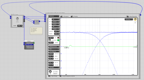

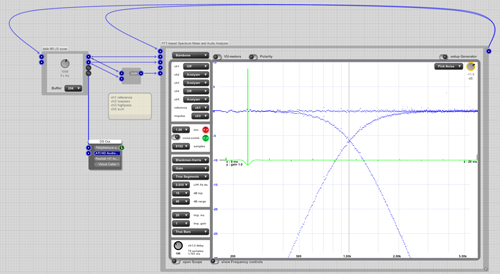

What makes the bidirectional IIR filter so remarkable, is the linear phase it delivers.
See the lowpass and highpass impulse responses (green curves).

bidir IIR LR xover highpass (500).png (58.92 KiB) Viewed 25792 times

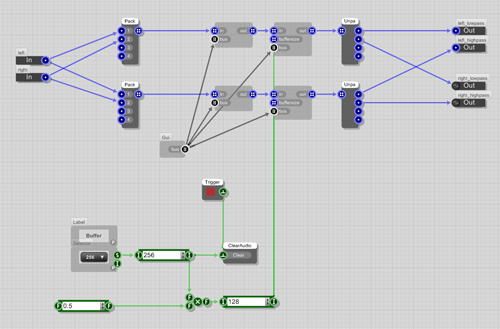

Here attached is the .fsm I'm talking about.
