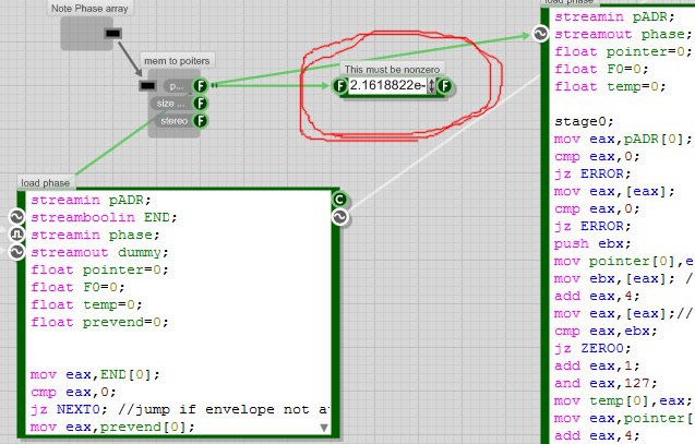

Re: Prototype - Free running poly oscillators
the pointer module should output nonzero value.
- memtop.png (57.99 KiB) Viewed 34121 times
