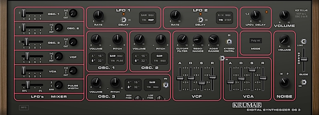

Here's another less-than-half-a-gift.
Spogg, you've shamed me (a bit) and inspired me (a little more).
Inspired by some of your comments in the minDy thread that sometimes a limited synth can inspire, and as regards emulations especially - there's value in resisting the temptation to pile on extra features and capabilities. So I did a version of the DS-3 that has most of the limitations of the hardware (except for re-jiggering the Poly section as a third multiwave oscillator).
Krumar DS-3_os ('os' for Old School)
And, shamed me into giving it a couple more presets than the original version.
