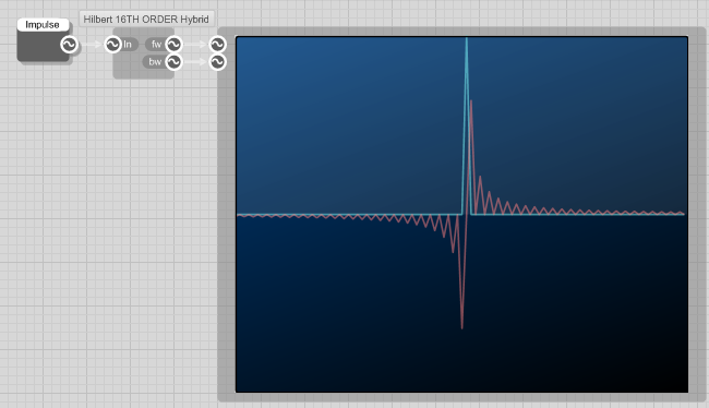

cbbuntz, I realized that your filter is actually a true Hilbert transformer, as opposed to my original allpass network!
KG, that's what you had asked for!
So I took the oportunity to optimize some more and managed to reduce CPU load by another factor 3 or so. It is still more CPU hungry than my allpass network, but certainly much lighter than an equivalent FIR filter would be. Good job, cbbuntz!
Hilbert transform with BW filters_2.fsm- (5.72 KiB) Downloaded 1708 times
- Impulse response of Hilbert transformer
- Hilbert.png (27.94 KiB) Viewed 37748 times
