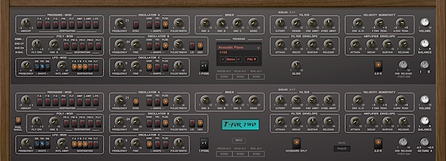

Here's the finished version with working keyboard splits using kortezzzz'z mods to the Ruby module, to which I added a direct MIDI output for P-Bend and Mod Wheel connects and a Preset module to store Split patches' split point. To the original Ruby module, I added a sub-module from another kbd split schematic that allows setting the split point by pressing the desired MIDI kybd note split point and pressing the computer kybd letter 'L'. Great fun when combined with the ability to pan each split 'voice' in the stereo field.
Loaded with two dozen presets
, mostly drawn from the T8's manual patch sheets, including a handful of Split patches.
Thanks so much Spogg for your initial inspection, and kortezzzz for modding the Ruby module.

I checked this out and it’s working well. It’s good to see all those 26 presets too! It does make a difference Kevin. It looks and sounds great!
Speaking about your presets, I was puzzled as to why I got no sound from the preset “Polyglide”. Is there something I’m missing?
Thanks as always for sharing your excellent work.

@Spogg - No, not missing anything (in more ways than one). That slot was left empty by mistake, but don't worry, the Polyglide preset is pretty boring and I should have left it out anyway; given it's name I think it was to demonstrate the T8's polyphonic portamento - which as I understand it is not possible with Flowstone, correct? Thanks for checking it out - I was pretty impressed with the Acoustic Piano preset; I'm sure with a little more tweaking it could be even better. Story goes that John Bowen discovered it 'by mistake' - my hunch is he probably left the Sync button on from a preset he was working on previously, and realized it provided the 'secret sauce'.
@Jay - I'm glad you put all that work in long ago, it really paid off for this project, once kortezzzz modded it for this specific context. And glad Spogg 'unearthed' it in the Synthmakers Greatest Hits' (though I thought Ruby only came about with Flowstone).
