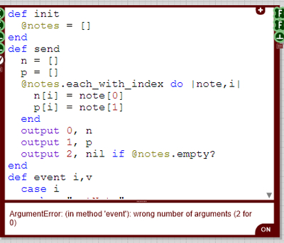

There seems to be something wrong with it on my machine.
It loads with a Ruby error,
which, when cleared recurs when you try and draw notes.
The error is:
But I get the idea, thanks so much for trying to help me nut this out.
The error is:

damn it! i'm using 3.06 where it is working fine, which methode fails with arguments? i didn't use any methode with 2 arguments
the only thing which is not done very proper is the update of the @notes with the preset input this should only happen on presetchanges and not each time the values are changing.. i changed this and updated the last download, but this shouldn't be the issue or?
i also included some lines for more detailed error message to find out where exactly the error happens..

method name "send" is built-in, you shouldn't overwrite it for any other purpose

Yep- that fixed it
Thanks Maik!
