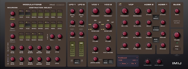

Here's an alternate version for those who love sync, even nasty aliased FS sync 8-) .

Standard oscs with crossfading waveforms; either osc can sync to the other. VCO 2 can track the keyboard or not, and go to Lo (LFO) range - tracking keyboard or not. Velo and Aftertouch can affect either osc singly.
Can also do simple FM from osc 2 to 1, shaped by the filter envelope.
