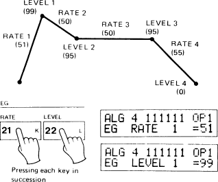

From this diagram it seems, the envelope of an operator is a standard ADSR. Is that right? Does anyone know what the total length of the envelope was?

The envelope generator isn't a conventional ADSR and the image of it is misleading :o .
When I first got mine it was a big confusion for me.
The env is actually very good and flexible but not easy to visualise or program. Each step of the env can be set for rate, value and shape. The final step is the sustain phase, leading to a single release phase. One of the good features of the DX7 env was that you could set level 1 at zero and by setting the rate for that stage you could implement a delay, determined by the rate setting. There was a bug in the implementation so the env didn't repeatably execute the correct time and Yamaha were aware of it but didn't correct it because the prototype was made in hardware and it would have meant a major delay in release as well as cost. However, it worked well enough to be useful. I don't know how the rate setting related precisely to time so I can't say what the maximum length of an the env would be. I do recall being able to set a very long overall period though, for long fades etc.
