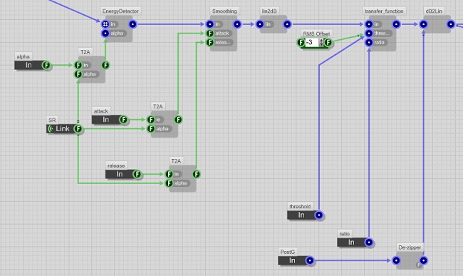

Side Chain Flow:
Attached is another version of an RMS compressor. In this version the 'side chain' signal flow is more common (like Martin had suggested).
Ths signal (within the side chain) flow:
--> Energy Detector (RMS calculation) --> Time based smoothing (Attack and release) --> Lin2Db --> Transfer function -- Db2Lin
(see attached image).
Smoothing Filter Mechanism:
The 'smoothing' mechanism is a simple first order LPF which (as discussed in this post http://www.dsprobotics.com/support/viewtopic.php?f=3&t=6274 ) far from ideal.
I still have doubts about this issue.
For instance, in Abelton Live's compressor (and other many examples), there are three 'latency settings': 0ms, 1ms, 10ms.
For the 0ms - one can only think of an IIR smoothing mechanism running inside (1st or higher order)?
Is this correct?
I agree that if latency (look ahead) is allowed the FIR (moving average) followes and therfore 'sounds' much better.
But what is the case of ZERO latency ?

Re: K1 - RMS compressor
One more topic:
I thought I would need a de-normalizer with the 1st order smoothing filter, so I'm adding and subtractin 1e-09 :
Does this make any sense ?
//if (in > out) then 'attack' else 'release'
c = release + (in > out) & (attack - release);
out = c * in + (1-c) * out + 1e-09 - 1e-09;
