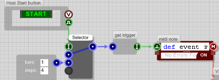

So the new sync module works pretty good! It doesnt crash the host when you change tempos much but I think its down to the mono2graph trying to grab x samples when x is changing!
The ppq ticker works well (must say its an accomplishment of yours!) but it still drifts slightly. Check the schm:
It seems that even though its accurate its still drifting around the sample start. Its an improvement tho

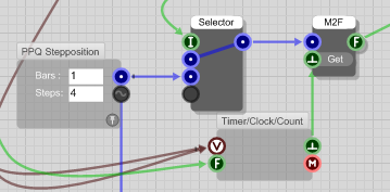

billv wrote:havn't got the ruby skills at the moment, so only a ruby guru can finish that idea.
No need for the ruby skills...I created the idea in green and it works.
It uses 2 ruby tickers, and tempo changes are in sync.
And there's no PPQ Module. In short, I've created a small automation circuit,
(in theory similar to the X11 system), to handle that PPQ Sync.
This is the first working version, I've got some more ideas to better it still.
. Maybe a few more tweaks here and there.....
