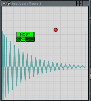

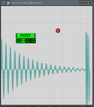

from what I can see, there is still a variation of the timing. Now that is based off my scope grabbing samples.
Surely it should grab each beat at the same time? So there should be NO variation?
So A kick on every beat and the scope changes from
to
as you can see slight variations. Always changing.

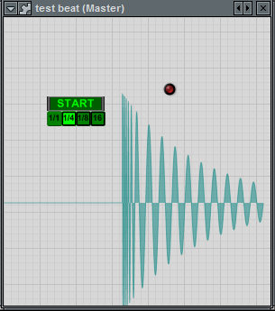

Now lets see only one kick on the first beat . . . (snapshot taken on 2nd beat)
This shows a few samples are shifted around the synced ticker. Its not 100% but I cant think of why it would be shifting like this if it was. Also the delay in grabbing samples from PPQ ticker is around one beat.

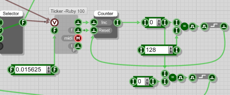

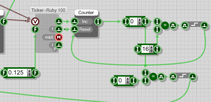

My main focus at generating a error is this......
Look at the v3 circuit. Notice it works simply by holding the user's selection
and delivering it at 0. the beat starts at 1.
I know if the user times his selection at point 0, the S/R accuracy seems to take care of it,
But I can't help thinking there is 1 in 16 chance of an error happening.
So i have been playing around with these two parameters.(ticker time and count number)
This seems to "tighten" that gray area up, no human is going to be that fast...
So if anyone gets an error, the first pic is probably why, and second pic is the Fix.
At the moment I'm leaving it as is with a host tick and a count of 16. No errors yet.
I new if took it up, sooner or later I would get an error, because the circuit is not "optimized".
Next i went up to 256 on the count and the circuit, as suspected, could not keep up.
The real interesting part is when increasing the count and the the timer like this,
watching those 128 numbers fly instead of just 16, sort of "opens the door for sub-sampling".
