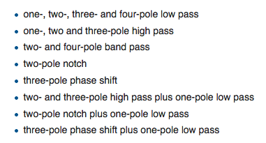

-Hello martin;
Here's the list of the Xpander's rather unusual filter states (from the Wikipedia page):
Also, this:

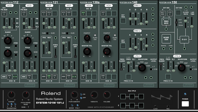

Now i has not found a JUPITER 6 as a Synthmaker Project,
has no other one so i made it now and share with you all if end.

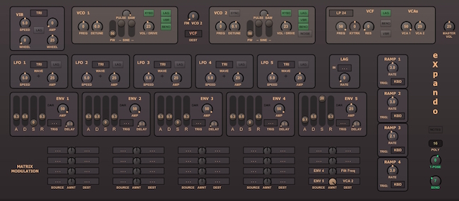

Turns out I didn't include eXpando in the Bundle, so here it is -with DAW automation compatibility.
Broadly an Oberheim Xpander emulation, but:
Filters incomplete and not very accurately emulated.
No Tracking Generators (couldn't figure out how).
Just the Voice, no splits, layers, six separate outputs etc.
https://www.dropbox.com/sh/8ymdr0rgtkvw ... Kcwga?dl=0
