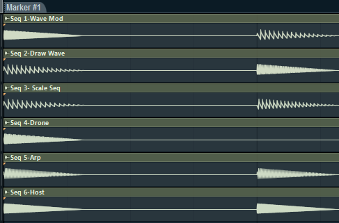

Re: Ruby delivers 100% Accurate VST Timing
Sorry guys, but all of my designs have been proven in-accurate.
They start drifting after a few minutes and continue to drift with time.
before and after 5 min
Look at the black line(host marker) in the background
And look again
So the timing issue is not dead- the dead horse is not only alive, but has bolted
from the scene.
So the headline "Ruby delivers ", for me, is FALSE.
Ruby has not delivered. Why?...
Because it is up to the "programmer" now, who can make ruby VST sample Accurate.
Yeh, so for me, ruby has lost its grip on the"holy grail" of timing accuracy.
The Ghost of the Holy Grail was last seen loitering around this man...
viewtopic.php?f=3&t=1267

Did that, but it looks like a false alarm.
Got it with my first attempt for the weekend.
It's just a "tiny fix" to the standard design I've been using.
Trog's work in his VST sample Accuracy post pointed the way.
here's the first test result:
At start
At about 5min
Give me a day or two, to test in other hosts and verify.
Will upload then.
Sorry if i gave anyone a heartattack. thanks for your patience.
Not sure weather to blame ruby now, or blame trog for the success, as the "tiny fix"
is sort of halftrog/halfruby.
- Posts: 1164
