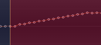

Now have a look at the same plug in, same host, but different machine, my main CPU
Sometimes it's on the money, and lots of times, it's like this

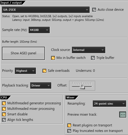

Now here are the setting's on my main CPU...
(Bear in mind here it's not my selections I want to highlight,
but the options that are available and how they differ)

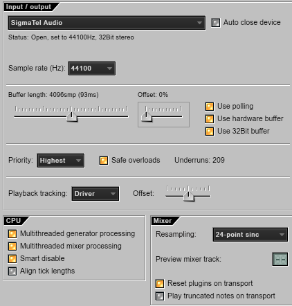

Now Look at the settings on the laptop.
Clearly there not the same.
Can you use this information Trog, the technicalities are beyond me, but I hope it
triggers something in that monster brain of yours
CONTINUED IN NEXT POST

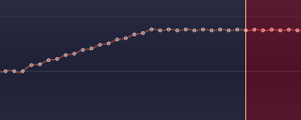

Now the problem I mentioned with PPQv6, was a slight error in the PPQ, or
sample rate maybe....don't know for sure...
To test, while running I toggled tempo's 1/4,1/2,whole,1/8 and not 1/3.
Error is like this,
Otherwise, on the laptop, v6 it's just perfect.

Thanks a lot, billy - will take a little while to digest, but I think that will be very useful information.
That second wave screenshot a few posts back is particularly intriguing - it is so far early in time that it looks as if there may well be PPQ delay compensation going on. I would guess that it isn't early for every single beat because the <= v6 code is assuming that there isn't any compensation - so when there is, it all goes a bit screwy!
The glitch when you switch time divisions is one of the things that I need to sort out - that bug happens in other hosts too - but I really wanted to get everything working the same in every host first so that I only have one "code base" to work out a fix for.
