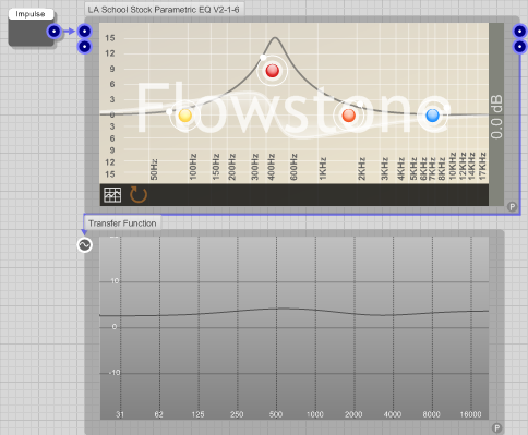

Postby martinvicanek » Thu Nov 15, 2018 9:40 am
Hm, I am getting strange results here. The filter response is by no means what the curve suggests. When I crank up any of the bands by 15 dB, there is only a subtle change in the actual response. Variation of Q has almost no effect at all. BTW a narrow peak has a high Q and vice versa - in your display it is the other way round.

Postby martinvicanek » Fri Nov 16, 2018 8:50 am
The displayed curve and the actual filter response are still very different:

Postby martinvicanek » Sat Nov 17, 2018 9:02 pm
I am not sure how your explanations relate to my observation above. Fact is that the modification dind't fix anything.

Postby wlangfor@uoguelph.ca » Mon Nov 19, 2018 3:15 pm
martinvicanek wrote:Hm, I am getting strange results here. The filter response is by no means what the curve suggests. When I crank up any of the bands by 15 dB, there is only a subtle change in the actual response. Variation of Q has almost no effect at all. BTW a narrow peak has a high Q and vice versa - in your display it is the other way round.
martinvicanek wrote:I am not sure how your explanations relate to my observation above. Fact is that the modification dind't fix anything.
Yeah, it's because only half the bell is actually affecting the sound. There is very little affect by this equalizer as yet. But I am meaning to do it; It's just an annoying pre-requisite that was straight-forward in nature. I'd realized I would have to do it eventually. For the time being I'm focusing on application, accuracy of the gauges and visual aids as well as the oversampling technique.
