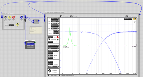

@KG_is_back : You are right about the delay! Attached is the subtractive version, and the "dumb" version. In the subtractive version I put a knob for slightly detuning (-10, +10) the delay, only for illustrating purpose. Leave the delay knob on 0 for applying the exact delay. While turning the delay knob, you can hear the highpass sound texture changing. Note how the delay tuning gets critical when Fc is high, say 3 kHz and above.
bidirectional_IIR_xover_subtractive.fsm- (9.03 KiB) Downloaded 1524 times
bidirectional_IIR_xover.fsm- (9.51 KiB) Downloaded 1474 times

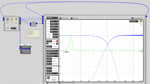

Re: Bidirectional IIR filter
I made Q adjustable.
Almost no preshoot and ringing when Q set to 0.600
Real Fc = 1000 Hz when Fc knob set to 1230 Hz
Lowpass slope 4th-order like Linkwitz-Riley.
Highpass slope something like 2.5nd-order.
Looks okay. Makes me happy.
bidirectional_IIR_xover _Q_subtractive.fsm- (9.22 KiB) Downloaded 1489 times

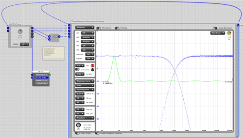

I made Q adjustable, and added knobs for adding a thin amount of bandpass energy and highpass energy in the woofer signal.
Real Fc = 1000 Hz when Fc knob set to 878 Hz
Lowpass slope something like 2.5th-order in the audio band.
Highpass slope something like 3rd-order.
Looks great. Makes me even more happy.
bidirectional_IIR_xover _QBH_subtractive.fsm- (9.73 KiB) Downloaded 1495 times

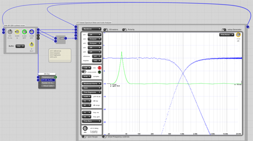

For completeness, here is what's happening when specifying a 1st-order lowpass.
No preshoot and ringing, of course.
Lowpass slope 2nd-order as expected.
Highpass slope 2nd-order as expected.
This could possibly deliver excellent results with quality woofers exhibiting a well controlled high frequency roll-off, and quality tweeters able to handle power down to 1 kHz. Kind of audiophile approach maybe. This is worth trying in first place, especially when applying 128-tap FIR filters for linearizing both drivers, individually.
I'd like to experiment this using 32-bit audio on a ARM Cortex-M4 like STM32F4 (168 MHz - two I2S), or preferably a MIPS Microchip PIC32MZ (200 MHz - three I2S). For simplicity, a WM8580 could be hooked as I2S clock master, for featuring the S/PDIF-in and up to 6 channels of analog audio out. Can somebody help ?
bidirectional_IIR_xover_QLBH_subtractive.fsm- (8.27 KiB) Downloaded 1348 times
