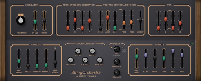

Looking at Kevins' Arp photo, I wondered, whether it is possible to geometrically tilt the slider base, to make sliders 3D.

Probably is, but beyond my skills. Closest I ever got was cast shadows that follow the 'tabs'; I was waiting for feedback from Martin about any corrections/suggestions/requests, before doing any more on this. It may not even be to his taste

While awaiting Martin's additions, I added for my own enjoyment a simple Delay to this - since this has a built-in reverb, and delay is most effective before reverb; so here 'tis:

Sorry about that, Kevin. I got carried away by a new oscillator design which is easier to control and more versatile, so the project scope somewhat drifted away. I like your Arp GUI style, though!
