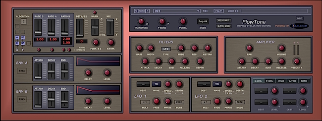

OK, you knew I wasn't going to able to let your generous contributions just sit there in a folder, didn't you?
AND you knew I would return with hat in hand, didn't you?
The other major items I didn't realize I had no clue how to do are the 'non-standard' LFO modes; I got the Free-run opton there, but the other modes - I have no idea. I can't even understand what the Hold mode does; the text is very unclear and the diagram isn't much help. The One and Half modes I understand what they do, just not how to implement them. The Half mode appears to be a 'one-shot' mode, so Speed has no effect?
Does anyone know of modulate-able first order filters? The ones I use are the only ones I've seen and are controlled with greens.
It's also very unclear to me what the distinction is between the various Ratio and Pitch mod destinations are. I guess the Ratio mods are stepped in the same increments as the Ratio controls, so would 'zipper' like crazy? - how would the Ratios be made modulate-able, since they are in green?
I've kept things pretty much as they are in Digitone; I've found most of the limitations more fun than frustrating. The only real change I made is giving the Harmonics control an added Strength control.
The manual has a lot of frustrating omissions regarding control ranges, etc ('0-127' doesn't help much).
I'd kind of like to make this a stereo instrument, but that would require doubling the Filters, and not sure how much CPU that would eat up.
Thanks tons for the huge kick-start you've given this - and if Adam ever checks in on this thread, thanks again for your generous permission to loosely base the GUI for Triple Paddy on 'Viper'; I've adapted it for use on FlowTone as well.
