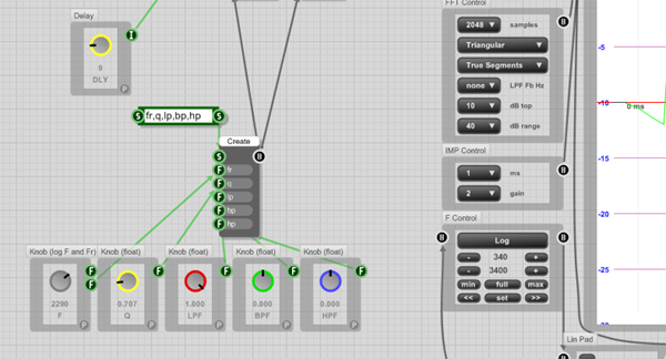

Indeed. For this application (the FFT-based Audio Analyzer) I would feel more comfortable, elaborating a single "master sync" properly sequencing the two FFTs, the two BiQuad IIRs, and the iFFT (for the impulse response). Following such idea, an other important trigger would be elaborated, asking the Draw. Is it possible to know when the GDI+ has completed his job? This would be useful, for explicitly blocking any new timebase trigger during those computations, avoiding a sort of queue buildup in Windows. A possibility is to provide an option like a timebase that's not fixed (500ms, 200ms, 100ms, ...), but instead a timebase that's adaptative like allocating 50% of the CPU time to the pipeline consisting of the two FFTs, the two BiQuad IIRs, the iFFT (for the impulse response), and the GDI+ execution.MyCo wrote:The easiest thing to do is building modules and examin what happens when a trigger comes in. When there are multiple triggers coming out at the same time, you should start thinking about, how to avoid that. Sometimes it is better to include explicit update trigger inputs, so no matter how much triggers come in, only the update trigger starts processing and updates the outputs.
By the way I just endured a Sync galore syndrom, after replacing the good old FS knobs (static with gauge) by some more ambitious knobs, that I modified (wiping out MIDI), appearing to work nicely when tested in isolation. Now guess what : if I replace all 7 old knobs by new ones, the schematic takes a lot of time for loading. Moreover, just after the load gets completed, the CPU usage is about 50% continuous, with the audio disabled and everything supposed to be idling in the schematic. I guess you are going to scream, realizing what's going on. Unfortunately I'm new with FS, and unable to deal with that otherwise than reverting back to the old FS knobs. I'm attaching the .fsm, just in case.
- Trigger galore caused by new knobs.png (98.77 KiB) Viewed 29791 times
FFT-based Audio Analyzer (LV xover) 102 (many new knobs).fsm- (318.27 KiB) Downloaded 1555 times

The new compact knobs feature a "double click" reset to a "default" value.
I managed to eradicate the new knobs Trigger Galore, by redesigning them.
The CPU is now at 0% when the schematic is idling - same as the old standard FS knobs.
See the attached .fsm
The "double click" feature is handy, but dangerous when the default value is zero.
Look the red-green-blue knobs. Double click on them, make sure they all display a zero value.
Doing so we ask the D.U.T. (the BiQuad) to mute completely, generating a zero audio signal at the BiQuad output.
Clearly FS can't cope with this. The program appears to block.
There may be two different issues with such zero audio signal.
- denormalization (within the BiQuad, or later on, like causing an extremely slow FFT execution?)
- divide by zero somewhere in the data processing
Can you please tell me what is the acid test or generic toolkit for knowing :
- if the issue is denormalization - and where
- if the issue is a divide by zero - and where
Thanks
Steph
