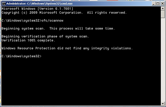

Postby RJHollins » Mon Aug 19, 2019 3:18 am
OK ... ran the CMD sfc /scannow app.
CMD - results.jpg (61.79 KiB) Viewed 18987 times
Result ... No integrity violations.
Still need to purchase a USB stick to do the RAM test.
