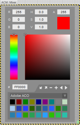

It was hard work, but here's r5.
Since nobody but Tronic answered my question, I didn't change export options. Blame yourself.
Before I can release it on Guru, it needs to be heavily tested. I don't mean a download and a quick look. I mean to actually use it while prototyping. It doesn't need to be your next synth, but it should be tested under normal development conditions.
If you are truly willing to test it in that way, leave a line here, and I'll pm you a download link. Then use it and report back here with everything you like to mention. Even if you're not sure if it is an issue. Or if you have problems with the GUI, etc.

To avoid having to write this a dozen times (yes, I'm optimistic that so many of you will be willing to help), I post it here. It's a user guide/reference
Working with ACM
First add the Mixer to your schematic on the top level. Then add receivers wherever you need them. A color you select in the receiver stays connected to the mixer. Any changes to that color in the mixer are instantly reflected in the receiver.

Group control
Here you manage all of your colors. Corresponds to the receivers. Whatever you enable here, will be selectable in the receivers.
Receiver
Appears just like the color prim. To make changes, select the properties. There you are presented with the groups and you select any of the groups and colors.

- Icon bar
From left to right: Import, Export, Delete Group, Add Group, Scroll one group back, Scroll one group forth
- Import:
A file dialog opens where you may select either .cex or .aco formats and then the file from which you wish to import colors.
Export:
A file dialog opens where you may enter a file name to export the current group to.
Delete Group:
Deletes the current group. If it is the last group a new group is created automatically.
Add Group:
Inserts a new group before the current group. If you wish to add a new group to the end of the list, press [CTRL] while clicking.
Give your groups unique names or select another group
- Name field: LMB - Edit color group name
Popup list icon: LMB - Open the menu to select a group
Each group's colors are displayed here. Each group consists of exactly one empty color field and unlimited non-empty color fields.
- Empty color field: RMB - Fill with current selected color. A new empty field is added automatically.
Non-empty color field:
- RMB - Replace with current selected color
RMB + [SHIFT] - Delete color field
LMB - Select this color (fills all number fields, the spectrum and the gradient control with this color's values)
Receiver
