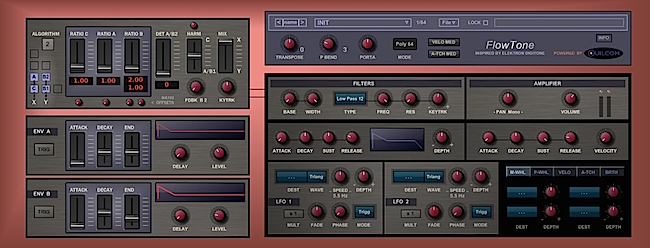

So, I'm getting close to finalizing this, but I've encountered a difficulty that I don't remember ever having before.
I added an additional item to the LFO's 'Mult' choices: "Kybd", where the LFO speed will track the keyboard. I got that all working fine, but when selected, the change won't take effect until any stream input inside the LFO is clicked on. Then have to do it again when switching back to normal ('x1').
I tried that weird '0 to output' thingy you came up with to address an issue with my 'maGGi' LFO; that doesn't work, then I tried force connecting an 'After Load' prim to a stream input, that doesn't do it either (?).
FlowTone dev4_stereo.fsm.zip
(1.19 MiB) Downloaded 832 times

I fixed the issue (in LFO 1) and added comments to the schematic.
I’ve had this kinda thing happen before. When a schematic gets complex I think the timing between green and stream gets dodgy. I don’t know for sure about the cause, but the solution has always been to add a de-zipper, since that would appear to provide a correctly timed interface between green and stream.
I should add that I found it unpredictable as to when such a thing is needed, but my guess is that it’s trigger related. My thought is that the de-zipper triggers a priority read of the green value at the moment the poly channel opens.
Or... it’s a bug! :lol:
FlowTone dev4_stereo -spogg LFO 1 fix.zip
3.06
(1.14 MiB) Downloaded 825 times
