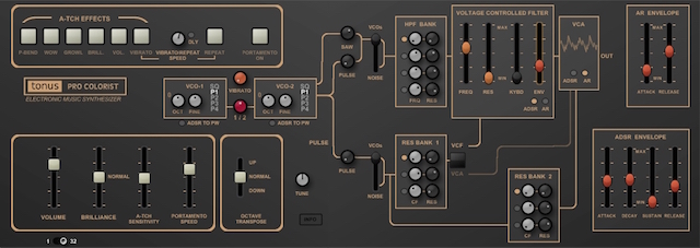

Postby k brown » Sat Feb 18, 2017 9:04 am
Fairly significant update to tonus Pro Colorist - level doesn't jump up with each additional HP or Res bank 'channel' that's switched on. Over-all level lowered to reduce internal clipping. Each filter path's waveforms are now controlled by level adjustments, rather than on/off buttons.

Postby DrewDale » Sat Feb 18, 2017 7:16 pm
Procolorist produces no sound at all in fl studio 12.4 no matter what parameter I change.

Postby k brown » Sat Feb 18, 2017 9:20 pm
DrewDale wrote:Procolorist produces no sound at all in fl studio 12.4 no matter what parameter I change.
It's a quirk of the filter switching - at least one 'channel' of all three (HP and both BP) banks must be on for audio to pass.
