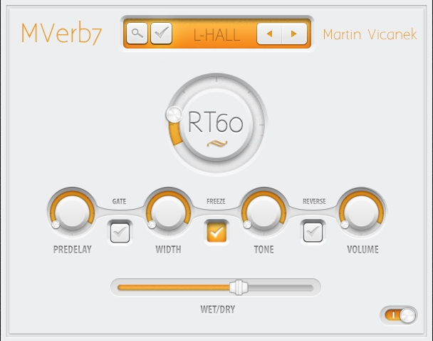

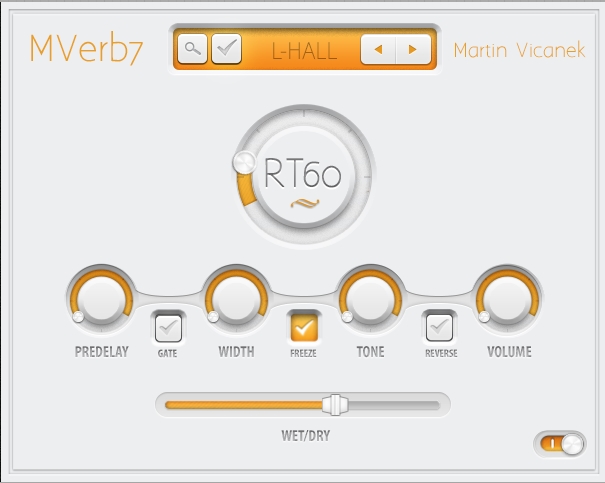

Whic ones do you guys prefer , Style 2 with fonts for the Gate , freeze and reverse on the bottom or Style 1 with thos fonts for Gate , freeze and reverse on top ?
I am unsure about on the top but dont really like them on the bottom either.
I do think it flows better on top but Just a bit unsure if its confusing from a user perpective that it belongs to the buttons ? Any thoughts?
- Style 2.jpg (88.97 KiB) Viewed 18054 times
- Stle1.jpg (88.07 KiB) Viewed 18054 times
