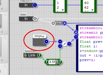

1. By convention, the MIDI song position reference is called PPQPos (or PPQNPos=Pulses Per Quarter Note Position)
and FS includes a component for that (see the image below).
2. The problem is that Ruby editor does not include a stream input accepting that signal, although it's not a downside at all.

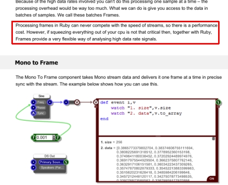

3. We can anyway use DSP (or Assembler) component, in fact, they are more appropriate for that, and much faster processing streams. Another option is to use the "Mono To Frame" (not the "Frame Sync") primitive, but I didn't test it heavily.
Resuming: Try to use Ruby and non stream components for intensively low/medium event processes where time accuracy is not crucial at a millisecond level, e.g. GUI controls, menus, midi inputs from instrument, array updates, ... and use DSP for audio process in real time, including for DAW message processing.

It doesn't need one. In a DAW, and in the Flowstone editor, when ASIO out is used, Ruby is always sync'd to audio. More precisely, it will always work in the current audio buffer. It should not have much issues being precise to the millisecond. I know of an arp done in Ruyb, that works precise and uses scheduled methods (methods that are executed at a specific timestamp). There's mono-to-frame to convert a specified number of samples from blue to RubyValue, this can be used to access blue data in Ruby.
While your general advice is valid, this specific case is the exception. DSPR spend quite some time on making sure, Ruby is sync'd, so it can be used for situations, where timing down to milliseconds or less is important.
EDIT: I forgot to mention the Frame Sync prim, which you can additionally use to trigger the RubyEdit EXACTLY when the audio outs request the next buffer. This is less interesting for MIDI, but very important for the fx chain, for example.

I didn't find enough information and working examples about "Frame to Mono" so I was not sure it was a good solution. The concept of using a large buffer for checking a simple clock or song position seemed too slow and complicated to me, but it works.
