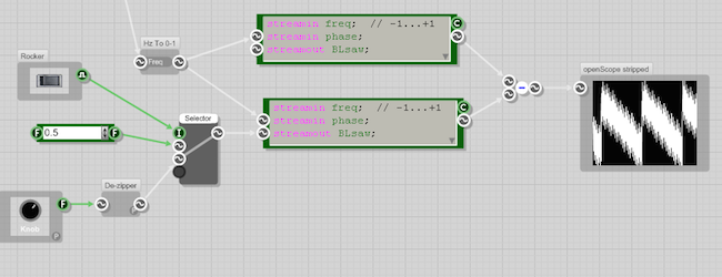

Since I'm the dope without FS, let's do this the other way 'round. Here's a schematic of my situation. With a 0.5 float - perfect square, with a PW control, a saw on acid. Maybe it's not the same saw you guys are using.
BLIT PWM mess.osm
(57.1 KiB) Downloaded 1141 times

In general, is there an advantage to doing PWM with a steam subtract rather than mixing the phase-shifted saw through an inverter?
It's the same thing.

The problem in your schematic was a faulty phase implementation :oops: Fix attached.
BLIT PWM less of a mess.osm
(56.98 KiB) Downloaded 1139 times

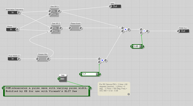

So, I tried your saw with the 'fancy' pwm (stays-centered) method and it didn't work! I noticed your oscillators have a different phase relationship to the stock oscillators. Here's how I modified the PWM to work with your oscs.
Centered PWM wVicnak BLIT Saw copy.png (109.7 KiB) Viewed 28169 times
Does this have DC on the output?
Re: Synthmaker bundle
Postby martinvicanek » Fri May 04, 2018 2:21 am
You can easily measure DC by placing a lowpass with sufficiently low cutoff. ;)
