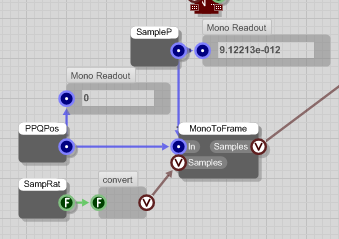

been playing around with the "sample position" primative
Do those two blue streams need some math before they hit the mono to frame?
Is better to re-write this picture in ruby???

billv, I honestly do not understand your timer.
first of all even if you MonotoFrame you set the buffer with the size of the sample rate,
it will still be synchronized with a tick every few sample buffer according to the audio drivers, for example,
every 512 samples, you'll have an update, even if you put 44100 samples, it will be divided into 4 ticks of 512 samples.
then you actually do not use the data for the PPQ or SamplePosition to calculate and send the midi to start,
so do not just simply connect the primitive Framesync, to the module ruby midi ?
So who makes the clock in your case is just that .... but maybe I'm wrong.

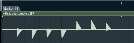

Re: VST Timing
Note polarity test picture in last post.
My question is obvious.
Why is the timer 100% accurate on the first bar of every measure?
Please note that i did not ask 'Why is the timer not accurate in those other places "
i need to keep the two questions seperate.
So again,
I'm thinking that whatever it is,in the circuit, that is responsible for this accuracy,
is a big clue.
So again,
is a big clue.

Re: VST Timing
Ok. So this is the first test using "accurate methods" as prescribed by FL Support staff.
Using X11 2.01(v2) Timer
This first test, at 3 min, is a failure, because my timer failed to show drift in the playlist.
CONTINUED NEXT POST........
