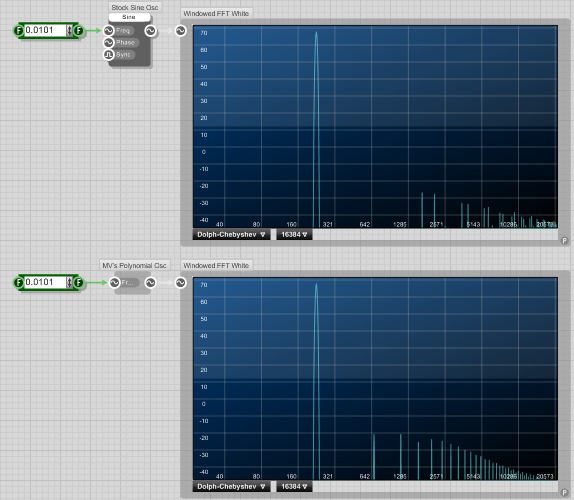

I found where I got that impression - a note inside his sine osc that says "some harmonic distortion (<90%)" - I think he means that distortion is <10%. Is this lower than the stock sine osc?

I don't know!
I would ask Martin because I don't know how to measure thd, sorry!
Or maybe someone here has a tool to do this...

PluginDoctor can measure THD of a VST plugin ... as well as other useful tests [freq response, phase, harmonics, compression curves, etc].

k brown wrote:a note inside his sine osc that says "some harmonic distortion (<90%)"
Sorry that should read "harmonic distortion < -90 dB". That's a negligible amount of distortion and, since it is harmonic, it would not be perceived as disturbing (as opposed to aliasing). The stock sine generator has (negligible) distortion, too.
