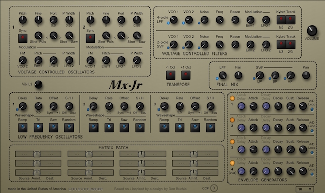

There's a little goodie at the bottom-right corner of the 'Mx-Jr' panel to change it's color from the famous Oberheim ivory white, to a rich, coppery color; saw a pic online of one this color - don't know if was some prototype or custom job or what.
Mx-Jr copy.jpg (235.27 KiB) Viewed 30886 times

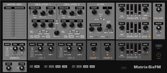

Personally I'm loving the Buchla-style (Aalto-concept) oscillators in the 'Matrix-SixFM' (thanks again Spogg for the wavefolder) - no reason this type of oscillator can't be coupled with a familiar subtractive-type synth architecture - the modular boys have been doing just this for some time now.
Matrix-SixFM copy.jpg (119.09 KiB) Viewed 30886 times

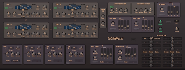

'tableBlend' is now much closer to the architecture of the DSI Prophet 12, with it's 16-slot mod matrix; filter, too is more like the '12 - in the first version I tried to 'lux it out with something like what the Pro-2 has, but it always seemed confusing to use.
tableBlend copy.jpg (148.06 KiB) Viewed 30886 times
