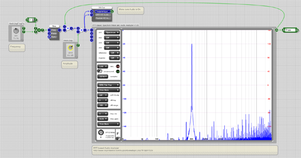

Currently there are five identified bugs or annoyances in the FFT-based Audio Analyzer (and Spectrum-Meter)
1.
When using the Analyzer as single-channel Spectrum-Meter, fort avoiding recurrent annoying "nil" errors you need to set "Reference" to "ch1" instead of "Off". The "nil" errors are coming from the "Quadrant Fix" Ruby code, still alive (it should not), expecting some data at the input.
2.

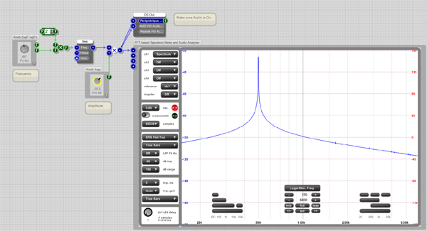

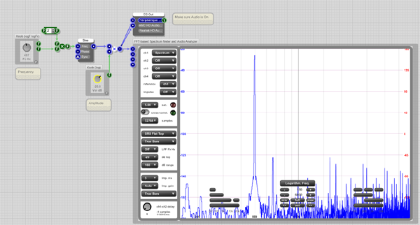

I can't figure why the 64K FFT is malfunctioning. Of course I'm using a very slow timebase (5.00 sec) for ensuring all audio data arrived before computing the FFT. The easiest way to spot the bug is to use the Analyzer in single-channel Spectrum-Meter, inputting the audio signal on ch1.
Let's use the Flowstone Sine primitive as signal generator, and plot the spectrum.
For all FFT sizes excepted 64K, the resulting spectrum gets correctly plotted.
For a 64K FFT size, it looks like the window gets set to "rectangular". Is there an array size limitation in Ruby, like 32K perhaps? What's an integer in Ruby? +32k to -32k ? 0 to 64k ? Anything else?
3.
Vertical scale in decibels when using the Analyzer as Spectrum-Meter.
I'm considering the audio to be "full scale" hence a having a 0 dB amplitude when a sinus (or any other wave) is evolving from -0.999999 to +0.999999. Am I correct ?
When inputting a -20 dB sinus signal into the Spectrum-Meter, I'm expecting to see a -20 dB spectrum ray.
Actually, the Spectrum-Meter is plotting a -26 dB ray instead of the expected - 20 dB ray.
Can you please tell me what are the industry-standards in use, for clearing up this matter?
4.
The program freezes when the user overloads the CPU by selecting a long FFT combined to a fast timebase.
5.
When using the Spectrum-Meter, most of the time the information you are looking at, is at the bottom of the plot area, like the noise floor or any spurious spectrum ray that may emerge from it. In such context it would be great to have a button enabling to show/hide the Frequency control pads. Is there a simple way for doing this?

- steph_tsf
- Posts: 249

steph_tsf wrote:2. I can't figure why the 64K FFT is malfunctioning.
When I remembered correctly, the FFT primitives have a size limit. But I'm not sure at this, maybe only the GraphFFT has this limit and the newer FFT primitives don't have that. That's worth a test.

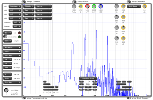

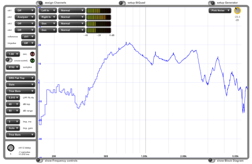

Re: FFT-based Audio Analyzer
Today I did Analyse measurements on a loudspeaker, using a high-sensitivity microphone connected on a high sensitivity mike preamp connected to the "Right In" input of my sound card. The high frequency response curve appeared to be "hairy" and unstable.
Actually, the analog input of my sound card went overloaded.
I thus added VU-meters in the "assign Channels" department, for checking the levels during the setup.
Later on I repeated a few Analyze measurements, unfortunately I could not reproduce the results. The frequency response was barely recognizable, unstable and corrupt by random spikes.
Did I forgot to define the reference channel, which is the most common mistake? Not at all.
Actually, for ch1 to be used as reference channel, I selected "Gen" input instead of "Left In" input.
It is important to know what reference signal the Analyzer is actually using in his computation.
"Left In" is the analog loopback (done through a special cable or dongle), telling the Analyzer what's the actual reference signal present at the D.U.T. input. In theory, this must be the voltage on the loudspeaker. Practically, if you trust your power amplifier, you can use the voltage at the input of your power amplifier.
"Left In" is thus coming 1) from a DAC processing the digital Ref signal, and 2) from an ADC processing the "Left In" voltage. So, why-Oh-why shall we use a possibly distorted signal like "Left In" as reference, instead of the "Gen" digital signal that's available, internally inside the Analyzer?
When selecting "Left In" as reference channel (ch1), there is no delay between the reference channel and the analyzed channel (ch2). This is a decisive advantage. This is the configuration to be used.
When selecting "Gen" as reference channel (ch1), there is a delay counting in hundreds of samples, between the reference channel and the analyzed channel (ch2), caused by 1) the DAC transforming the Ref signal into a voltage, and 2) the ADC digitizing the analyzed channel (ch2). The Analyzer has a difficulty extracting the transfer function when there is a such delay between the reference signal and the analyzed signal.
I'm considering adding a .bmp inside the "assign Channels" department, showing the special cable or dongle to be used for re-injecting the sound card physical "Out" into the physical "Left In" (reference signal), when the signal to be analyzed is actually entering "Right In".
- FFT-based Spectrum Meter and Audio Analyzer v1.02 (standalone) (500).png (41.37 KiB) Viewed 30052 times
