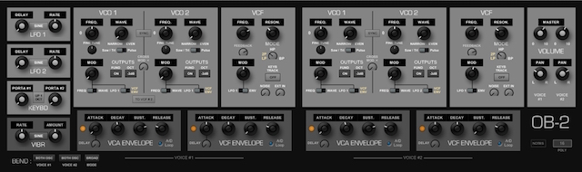

And, still on my Oberheim obsession: A Two-Voice version of the OB-1.
OB-2.zip
(1.78 MiB) Downloaded 1282 times
OB-2 copy.jpg (89.72 KiB) Viewed 30221 times

Postby k brown » Thu Sep 08, 2016 9:19 pm
OB-2 originally uploaded with a dead Voice #2; link in that post is now to the corrected version.
