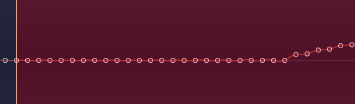

Ok, screwed my head back on and took another look at what your doing......
First test, and it's like this at every (song jump) marker...
Great work mate :D
And even better is that the test unit was thrown together really really quick,
the circuit looking back on it, is rough as guts. So, yeh, a good sign for your ticker :)

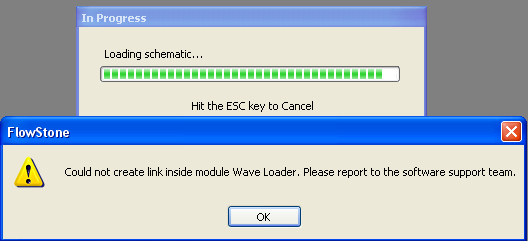

I got issues here....couldn't open FSM.....locked up CPU, force re-start...???????

Old SM Wave player module creating a problem . . . :mrgreen:
Updated here, you should export to vst to check it out.

Cheers mate, thanks for that. File opened + saved..all good.
