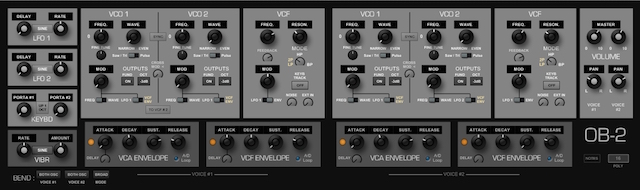

I did an update to OB-2 with enhanced envelopes; they are now exponential and have delay and A/D Loop (when either of these is used the EGs are linear).
More importantly, I gave all the controls unique Preset names - let me know if this makes the Presets work in a DAW, or if more needs to be done.
https://www.dropbox.com/sh/94zkxdb9je9x ... IV5ja?dl=0

Just tried it out in Tracktion - saves and loads presets AOK. But maybe Tracktion is just functioning the same way vstHost/SAVIhost does?

They have names now in Reaper, seems like it is fixed by your changes
Anyway, there are still some unnamed parameters in the list but they don't seem to have a function:
http://i383.photobucket.com/albums/oo27 ... cr7oni.png
If the demo of FS is fully functional, and you can explain how to edit the defaultnames with the correct ones, I am still willing to help.
