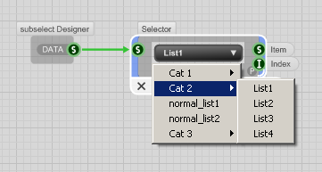

I made a Sub-Select designer
Well i'm using Synthmaker/Flowstone since some time .... and i just found out that this is possible
So i just made a little designer example for it
Regards
Regards
sel_cat_designer.fsm- (2.04 KiB) Downloaded 1543 times

Thanks, I was just trying to recall from the past - how it was made, because need to reorganize some menus into subsections.
Re: Sub-Selecetion Designer
tester wrote:Thanks, I was just trying to recall from the past - how it was made, because need to reorganize some menus into subsections.
It is done like this
Cat 1,>>,List 1,List 2,<<,Cat 2,List 1,List2,>>,Normal List1,Normal List2
So:
>> Go into Subselection
<< Leave Subselection
Regards

you can also save some space in dropdown menus when using "interactive" lists.
here is a simple example. if MIDI Learn is off, the menu will only show the option"activate learn" .
when learn mode is active, the menu will only show "deactivate Learn".
with this method you can easily manage submenus with more than 1 possible item "checked".
