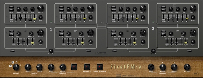

Hello, friends - long time no see.
Having an extended gap between recording gigs, I was playing around with SkematicGS, which I like a lot, but I have to admit I've tired of the Skematic-style GUI - it was a fun thought-experiment, but I always winced a bit when I went to use it; for one thing, I'm not crazy about high-key GUIs.
So I had the idea to redo the GUI to reflect the appearance of the GS1's wood piano-style case for the area of the performance/global controls, and do up the operator programming area in a CS-80 style.
I like looking at / working with this much better.
All that's really left to do is fine-tune some of the presets from SkematicGS, that got a bit out of kilter in the transition.
I added the additive carriers feature from SkematicSC, so now it hints a bit at the structure of the Synclavier (4 mod/carrier pairs with additive carriers). Clicking on the 'ADD' buttons below the carriers will display the additive osc harmonics controls.
One bit of fine tuning I'd like to do, that I need some help with is the clockwise two positions of the Detune control (Random Detune), which is described thusly in the manual:
"With the GS1's random detuning, overall depth is determined by the Depth setting ("1" or "2"), but an additional "random" factor is introduced on each note. Notes played one at a time will always be detuned by the same amount, but notes played in groups will each be be detuned by a different amount that depends on the order in which the notes are played."
I'm not even sure I know exactly what that means, but does anyone who might get it, know if such is even possible with FS? The way I have it now, the detuning is random, but all the notes in a chord are detuned exactly the same; has a very static sound.

Playing around with the synth a bit, it seems to me like the wave read osc prim used by the additive oscillator doesn't do phase modulation ('FM') nearly as cleanly as Martin's sine; and feedback even less well. So I just finished re-doing it with the additive module from Spogg's 'Mystery' (with added oscs to bring the total to 22; close to the Synclavier's 24), and I think it sounds much better. Only drawback is the loss of the ability to save/load additive waveforms and copy them to other oscillators. The use of regular sliders is much less 'twitchy' than the toolbox additive osc, though.
I also expanded the feedback options. There's no info on the net that I could find, about implimentation of feedback in the GS1's programming computer. The algo diagram I found doesn't show any feedback, just the cross-mod between modulators. I find it hard to believe that the programmer would not have allowed for feedback (afterall, the thing had EGs with something like two dozen break points!). So I added two controls in the carriers to allow feed back from the carrier to it's modulator, and from the carrier to the modulator in the neighboring pair. Added to the cross-mod which amounts to a 3-op stack, this provides much of the feeback options of the DX7.
Now, just need to figure out how!

I think that did the trick - sounds good to me. Thanks, Spogg (and Adam).
Here's v1.02, with your (expanded) 'Mystery' additive osc module, and addtn'l feedback controls.
