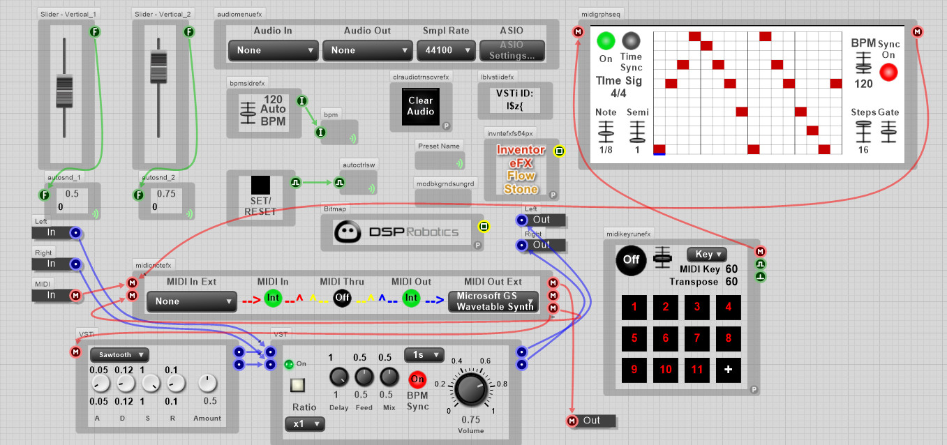

In this design there are two master 'wireless' slider controls:
(1.) The adsr amount (w/value add)
(2.) The decay volume (w/value add)
Both these mod's internal control for the adsr amount & decay volume still operate normally.
The master 'wireless' sliders can 'override' them
to demonstrate the 'wireless' ajuto snd/rcv function
for a variable resistor (potentiometer).
Variable controls now have value readout.
Now possible to click on a 'bold white' value and edit directly in the executable or vsti.
Variable controls have "minimum/maximum"
0-1 limit edit protection.
Use the set/reset button to auto adjust all values at once after edit.

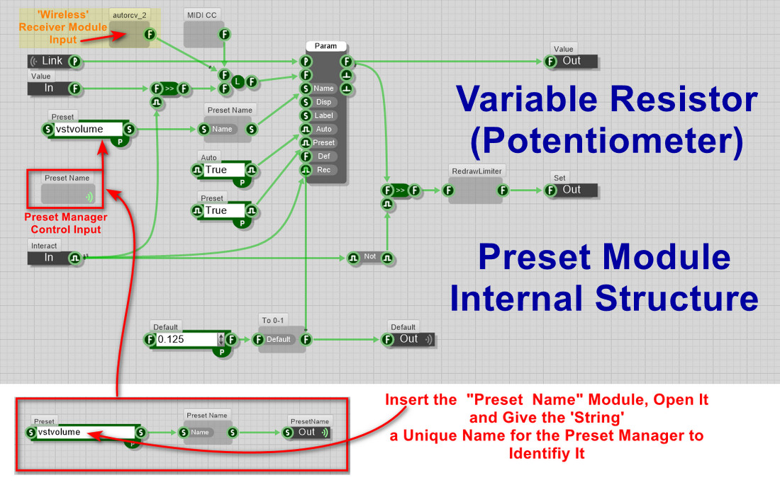

PRESET MANAGER EMBEDDED LINK MODULES
Next it is advisable to uniquely identify all controls
that are to be 'Linked' to a Preset Manager.
EXAMPLE FOR VST VOLUME CONTROL:
'Link' for Preset Manager
Mudule Control Information
Module:
(+++) Preset Name
String Value:
vstvolume
(REFER TO IMAGES BELOW FOR INFO)
View Image:
https://www.inventfx.com/_inventfxfston ... trlmod.jpg
View Image:
https://www.inventfx.com/_inventfxfston ... varstr.jpg

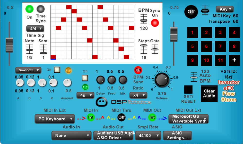

EXECUTABLE IMAGE
'Wireless' Master Multi-Auto Control Design
In order to get an idea of the concept simply
download the project with schematics and files:
https://www.inventfx.com/_inventfxfston ... toctrl.zip
View Executable Image:
https://www.inventfx.com/_inventfxfston ... trl_lg.jpg
View Schematic Image:
https://www.inventfx.com/_inventfxfston ... _schem.jpg
IMPORTANT! Be sure to replace the entire project
with the latest update download.
This latest update includes added preset manager
properties mods to the vsti adsr mod and vst decay mod controls.
An addiional 'Wireless' Master Multi-Auto Control Design 2 with 2 oscillators.
Includes FSM schematics, executable and vsti.
On/Off switch for the ADSR.
Auto BPM slider control.
Increased maximum delay to 16 seconds for 'loop playback' effect.
Improved BPM delay sync rate.
The decay mod 'green led switch' has been replaced with
a standard 'green led' so that the 'white square button'
is now the 'autosnd' off/on to demonstrate the
'wireless' auto snd/rcv function for a switch.
View Values Edit Image:
https://www.inventfx.com/_inventfxfston ... rl_edt.jpg
