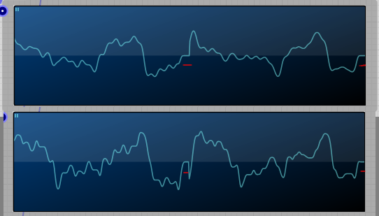

That's very impressive to do this with Ruby !
But one drawback specially with this type of effect is that Ruby is slow,
i don't understand what really do your code but i suspect that it take more cpu than a code in assembler or dsp.
On flowstone 3.6 i get 20% cpu, on flowstone alpha 4%.
I get a bug when i use it, a lot of noise. The sound is interresting appart that.
That's maybe because instead of using the ds in primary sound (i don't know how to use this..) i connect a synth to the mono to frame, then i have to connect also a M2f to the synth or there's no sound.
I could see on the scope where seams the problem, that's very strange.
When i play some notes the sound seams normal but after some while, i could see that each 256 samples there's some sample that are zero like they are not calculated, here with a 512 sample scope :
When i play again, the problem disappear then come back..

Hum, it could not be the synth i use. That's the vsti prim a very simple one,
it worked with ton of stuff and never fail.
I made another test creating a vst with it and trying it with Lmms getting the same noise.
I don't know much about the mono to ruby voice thing, but maybe there's something in your code that set the size of the buffer, making an error when a computer have another size ?
Sorry to give bad new, but they might be a way to fix this or if there's not we might ask Myco to fix it on alpha.
oups, sorry for the anotation in assembler, once we learn and use it we forget how much it looked chinese before.
Also it's not easy because everything might be done with register. Once we do a calculation it's no more a variable with a clear name but a xmmx or a eax, ebx, and even more with alpha.. So we forget that xmm1 was a+b.
I have problem myself when coming back after a while to a code.

Tepeix, yes may be your DS buffer differs from mine which is 256. Try experimenting with array.shift(256) method and put there some other buffer length and see if if fixes your distortion. Also, could you share your schematics to reproduce that?

Here it is.
I tried other number and also "@insnd.size" but is what not better
