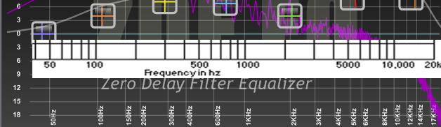

Re: Troll XMas: ZDF EQ
Looks like Hz markers are partly off a bit.

juha_tp wrote:Looks like Hz markers are partly off a bit.
Yes I designed this for 48000 sample rate; I'll make all of the other sample rates so that it matches up. I have other daws so I can test and implement for every sample rate affected. A lot of work; But I've been training to make the "real thing". I knew what I was getting into. This 44,100 I assume?

It dawned on Me that I could set the sample rate to be static; it only goes to a certain level anyways.
Also, there's a bug with presets. I was able to fix the q presets by adding a 1 subtracted by the preset value and created a physical connection to the preset parameter.
That's all well and good but the decibels were trickier. That'll be tough to solve but I am very glad that I got over the hump of crashes. I'd noticed while working on the Stock EQ that the base equalizer code crashes FL Studio when the CPU was taxed by 40% or more. And that of course was My first priority. This new style of bell location and co-ordinates implementation seems to bypass the same phenomenon.
I'm glad of that, and it just goes to show You that sometimes it's worth making it from scratch. So, tonight I'll get that done; Prepare a custom dropdown menu using rounded rect primitives and mouseover, and so on. I'll add: default, peak, low shelf, high pass, band pass, high shelf, low pass, and de-esser.
I noticed also an issue when initially clicking the bells that they change in location and I'll troubleshoot that too. But no crashes, thank God.
And BTW, the method I used for X-Y Co-ordinates and Parametric EQ Bell manipulation is CCO, I made that from scratch. You'd probably want to mention Acrobat and Troggludite though, Exonerate, and MyCo as well; For I'd used some of their stuff (and so did the stock primitives); or sometimes at least as references.
But this Parametric EQ as a whole is CCBY. I decided to Re-add KG_Is_Back's Ruby FL Studio Style analyzer due to the fact that it is stalwart. I liked the hanning/nutulya analyzer by MV, Trogg, RL, Cyto but it drove My CPU to 99%. A shame cause I loved the style.
