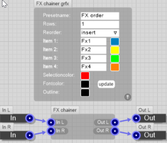

for shure you all know how to reordering your signalflow using busses, it is pretty handy but the audiodropouts and the work to avoid audiocrackles because of recompiling is really annoying, so i thought it would be great to havea solution in DSPcode/asm to reorder your fx on the fly without any audio dropouts...
for the ruby selector i used some technics from trogs cell array - thanks for that!
- 2018-12-21 00_13_03-FlowStone - [FX-order.fsm_].png (95.57 KiB) Viewed 22511 times
- 2018-12-21 00_12_22-FlowStone - [FX-order.fsm].png (31.13 KiB) Viewed 22511 times
FX-order.fsm- (5.31 KiB) Downloaded 1165 times

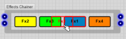

finally, i added a ghost slot which appears when dragging a slot from one position to another.
i also implemented a second option how the position changing is done, you can choose between "swap positions" and "insert at position" in the swapOrder methode
a question to all DSP code and asm gurus, can this code be optimised in any way? i was watching the asm code for it but couldn`t really optimize anything inside?
the updated file is in first post
